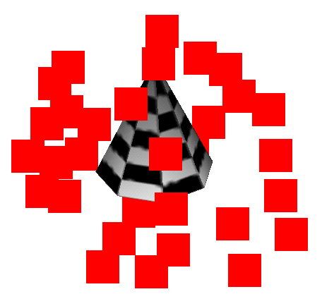

Suppose you’ve used the Particle tool to create a small number of red particles surrounding a checkerboard cone. The particle object is named Squares. It is displayed in the Points render type with a large point size, so the particles look like large opaque squares.

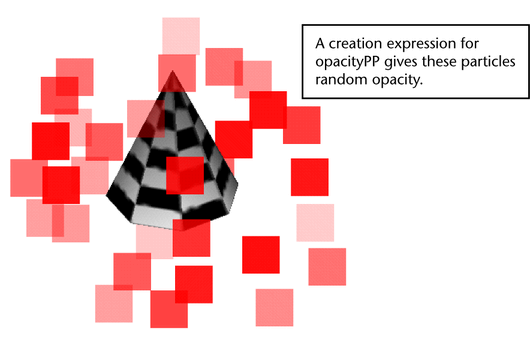

- Create the following expression:
SquaresShape.opacityPP = rand(1);
print("Hello\n");
- Rewind the animation.
Because opacityPP is a per particle attribute and the object’s particle shape node is selected in the Expression Editor, the expression does an execution loop of both statements once for each particle in the object.
Because the expression is a creation expression, it executes after the expression compiles. It also executes when you rewind the animation after playing it.
For each of the particles, the first statement assigns the opacityPP attribute a random floating point number between 0 and 1. The rand function returns a different random number each time it executes, so each particle has a different opacityPP value between 0 and 1. Each particle therefore has a different opacity at birth. For details on the rand function, see Useful functions. The second statement displays Hello in the Script Editor, once for each particle.
When you play the animation, the creation expression does not execute. The particles therefore retain the opacity they received upon rewinding.
Every time you play then rewind the animation, each particle receives a new random opacity. The creation expression executes the random function each time you rewind.

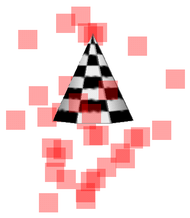

- In the Expression Editor, turn on Runtime (before dynamics or after dynamics).
- Create this runtime expression:
SquaresShape.opacity = linstep(0,5,age);
- Play the animation.
The runtime expression executes each frame during playback. The statement in the expression executes once for each particle and assigns the opacity attribute an identical value between 0 and 1 according to the linstep function (see linstep for details). The values rise gradually from 0 to 1 for the first five seconds of the object’s existence.
