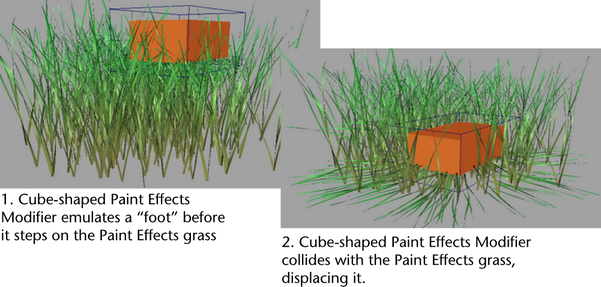

Example using a Paint Effects modifier
In the following series of images a cube-shaped Paint Effects Modifier exerting force is keyframed to simulate a foot stepping on a patch of Paint Effects grass. An orange cube is parented to the modifier to make it easier to see where the modifier is located in the scene and where it is exerting force.
