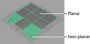

A polygon face is planar when:
  • all of its vertices lie in a certain plane. For example, a triangle face is always planar, because its three points define a plane.
A polygon face is non-planar when:
  • it has more than three vertices, and one or more of those vertices do not lie in the same plane. When a polygon mesh is comprised of quads or n-gons it is possible to have non-planar polygon faces.
Try to create planar polygon faces on your polygon meshes whenever possible. Non-planar polygon faces may render incorrectly in your final images or when exported to an interactive video game console. For example, a visual shaded line or an unwanted spike may appear on the polygon mesh where it has been subdivided for rendering because it is non-planar.

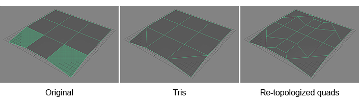

  • To correct non-planar polygon faces you can use the Multi-Cut Tool to split them into planar tris or retopologize the faces to better handle the bend point.
