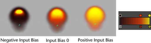

- Set an Interpolation method to specify how values blend between each Selected Position (point) on the ramp.

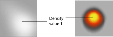

- Set the ramp’s Input to specify which fluid property is used to map the input attribute value.
For example, a grayscale ramp and a color ramp with a black, orange, and yellow mapped to Density appear similar to the following:
- Set the ramp’s Input Bias.
