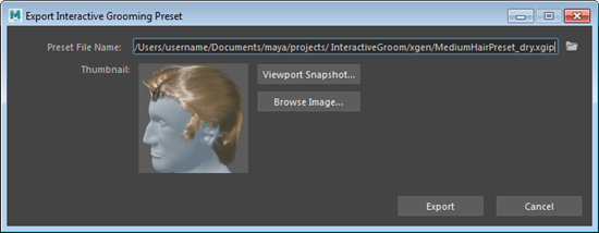

Save interactive grooms as presets
- In the Interactive Grooming Editor, select the description you want to save as a preset.
- Select .
- In the
Export Interactive Groom Preset window, click the browse icon
to save the preset to a specified location.
By default, preset files get saved to the xgen directory of your currently set Maya project.
- In the File Save window, type a name for the preset beside File Name, and then click Save.
- (Optional) Add a thumbnail image to identify the preset in the XGen Library by doing one of the following:
- Click Viewport Snapshot to create an image from current scene view.
- Click Browse to locate an image file.
- Click Export.
