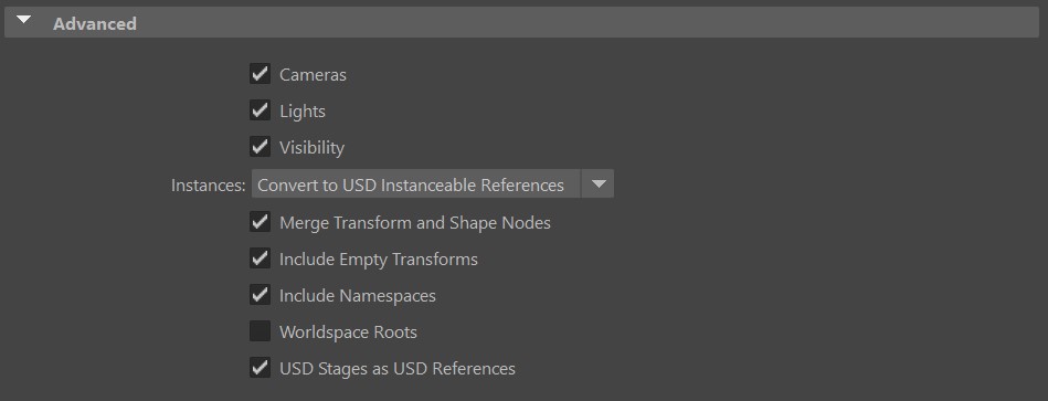

Advanced
Cameras
If selected, default cameras from your viewport are exported.
Lights
If selected, lights in your scene are exported.
Visibility
If selected (default), exports Maya's visibility attributes as USD metadata. If the object is hidden in Maya, then the following metadata is included in the export visibility = invisible.
Instances
Lets you export instances by choosing from the following options:
  • Convert to USD Instanceable References (Default): Exports Maya instances as USD instanceable references.
  • Flatten: Instances are flattened.
Merge Transform and Shape Nodes
If selected (default), merges transform and shape nodes into a single USD xform prim.
Include Empty Transforms
If selected (default), transform nodes that do not contain any child (empty transforms) will be exported into Xform prims. Deselect it to exclude empty transforms from the export.
Include Namespaces
If selected (default), namespaces are exported to the USD file in the following format: nameSpaceExample_pPlatonic1. When off, namespaces are removed from the USD file.
Worldspace Roots
If selected, exports the root prims with their worldspace transform instead of their local transform.
USD Stages as USD References
If selected (default), a Maya USD proxyShape is exported as a USD stage with a reference to the USD layer that contains the original stage.
