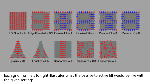

You can specify a ratio of passive curves (Passive Fill) to active curves. Passive curves interpolate the dynamic behavior of active curves, but are less expensive than simulating every curve. See Passive Fill.
More specifically, passive follicles have their motion defined by interpolating the motion of neighboring dynamic follicles, rather than computing their own motion. They can be used with both Paint Effects and NURBS Curve output.
If a passive hair does not have an input Start position curve then its shape, in addition to its motion, is determined by interpolating the neighboring dynamic hairs. Dynamics, forces or collisions are not computed on passive hairs. (The Simulation Method attribute on the follicleShape determines whether a hair will be dynamic, passive or static. Static hairs simply keep the Start position and do not animate.) (See Start, Rest, and Current Position curves.)
The Passive Fill attribute determines the proportion of the follicles that are initially set to active versus passive. If the Passive Fill is 1, then every other row and column of follicles will be passive (with the points not in these rows or columns being dynamic). If it is 2 then there will be two rows/columns of passive for each row containing dynamic. The number of dynamic hairs goes down dramatically as the Passive Fill increases. If the motion of the hair is relatively uniform you might not see much difference when a large percentage of the hairs are passive. However the Passive Fill will be uniformly interpolated between the active hairs. This creates a uniform mass of hair, without requiring self collision.
