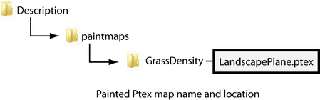

Ptex file names and folders
When you create a Ptex map in Maya, the Map Name you specify is assigned to the folder name that contains the Ptex file. The Ptex file name is derived from the polygon mesh object you paint on. Maya stores the Ptex folder and file in a paintmaps folder, which is stored in the Description directory. For example, if you painted a map named GrassDensity on a polygon mesh named LandscapePlane, the folder and file structure appears as:
