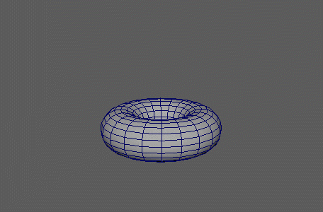

Extracts a mesh's faces and transforms them according to existing MASH points. The extraction process is different from a typical
Extract command, as faces are not actually separated in the DAG. As a result, the model's smooth shading is retained.
Note: Generally you'll want the number of points in the MASH network to be equal or exceed the number of faces in the exploding mesh. Faces without a corresponding point to transform to will bunch up.
