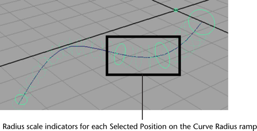

The overall radius of the volume axis field on a curve is set using Section Radius. Using the Curve Radius ramp, you can vary Section Radius along the length of your volume axis curve. When a position marker is added to the Curve Radius ramp, a Radius Scale indicator is placed on the curve in the scene view. These indicators show the points on your NURBS curve where Curve Radius is scaled to specific values.

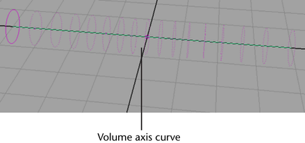

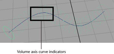

    In the scene view, dotted rings appear around the NURBS curve to indicate that the curve is now a volume axis curve.

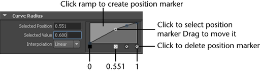

  3. In the Volume Control Attributes section, under Curve Radius, set the ramp options by doing the following:
    • Click the ramp to create a Selected Position for a Section Radius value. The left position on the ramp represents Section Radius at the base of the curve, while the right position on the ramp represents a Section Radius at the tip of the curve.
      When a position marker is added to the Curve Radius ramp, a Radius Scale indicator is placed on the curve in the scene view. These indicators show the points on your NURBS curve where Curve Radius is scaled to specific values. For more information, see Volume Axis Options.
    • Set an Interpolation method to determine how Section Radius blends between the positions on the ramp. See Volume Axis Options.
