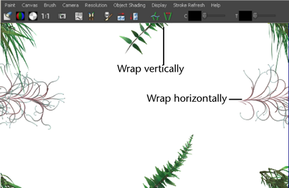

- Wrap H, Wrap V
These wrap options are useful for creating seamless repeating textures. For information on creating seamless repeating textures, see Create seamless repeating textures.
Turn on Wrap H to “wrap” the canvas horizontally. Any strokes that go past the top or bottom of the canvas will continue on the opposite edge as if the canvas were joined along the left and right edges.
Turn on Wrap V to “wrap” the canvas vertically. Any strokes that go past the left or right of the canvas will continue on the opposite edge as if the canvas were joined along the top and bottom edges.
You can see where the wrapped edges join using the Canvas > Roll command. For details, see Roll the canvas in Create seamless repeating textures.
You can also wrap the canvas using the wrap icons on the Paint Effects toolbar.
