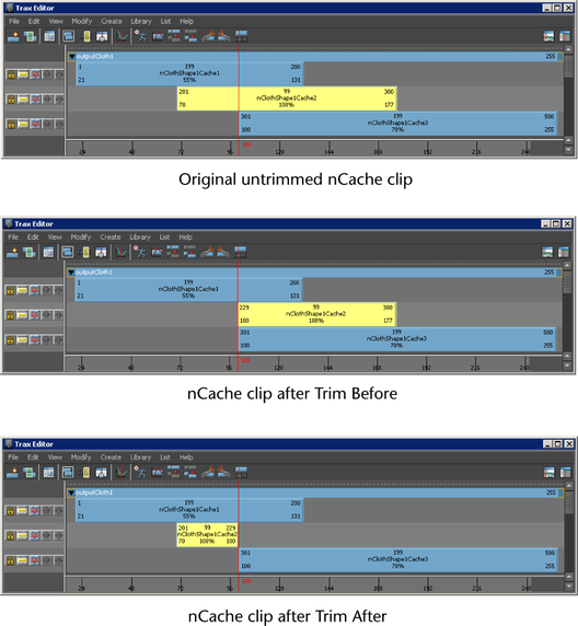

You can trim nCache clips to omit segments of simulation from the beginnings or ends of your cache clips. This changes a cache clip’s Source In and Source Out times. Trimming nCache clips does not affect their associated cache files on disk. The segments that you omit from a cache clip using Trim are not deleted, and can be reinstated if the cache clip’s original length is restored.
To trim nCache clips

- Select the nCache clip you want to trim.
- Do one of the following:
- Drag the top corner clip hotspots to trim your cache clip.
- Position the Trax current time indicator as desired, and
-click the cache clip and select Trim Before or Trim After from the context-sensitive menu that appears, or in the Trax menu bar select Edit > Trim Before or Edit > Trim After.
If you selected Trim before, the part of the cache clip that comes before the Trax current time indicator is removed from your cache clip. If you selected Trim After, the part of the cache clip that comes after the Trax current time indicator is removed from your cache clip. See Trax toolbar.
