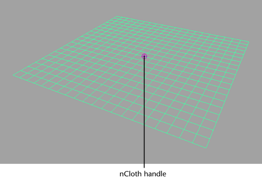

When you create an nCloth object, the following occurs: a new Maya Nucleus system of nodes is created and new connections are established for the selected mesh, and an nCloth handle appears on your new nCloth object. If the selected polygon mesh is made up of quads, then the Maya Nucleus solver also tessellates the selected polygon mesh and generates cross links. If the selected polygon mesh is made up of triangles, then cross links are not generated for the selected polygon mesh.
You can use the nCloth handle to quickly select an nCloth’s shape node (nClothShape), which then becomes the current selection in the Attribute Editor.
