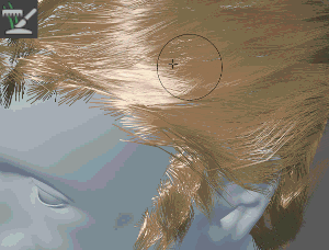

Adjust brush size |
B + drag or middle mouse button (MMB)-drag left/right |
B + drag or MMB-drag left/right |
The tool cursor resizes larger and smaller as you drag. |
Adjust brush size from 0 |
B + MMB-drag left/right or Ctrl + MMB-drag left/right |
