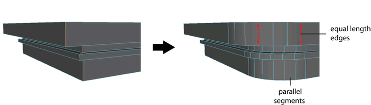

Performing a bevel operation on any mesh produces predictable results. In the following example, several corner edges are beveled. All of the beveled edges are equal in length, and the new segments are parallel.
