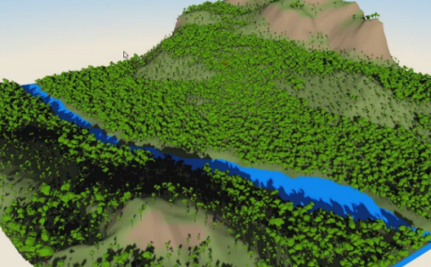

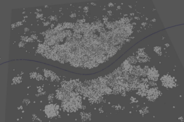

Terrestrial Ecosystem
Specifies the parameters of a Terrestrial Ecosystem-based Cluster Mode. When simulated, the starting points are treated as seeds, which age into plants, which sew new seeds, etc.
- Ecosystem Age
Determines the number of years to simulate the aging/seed dropping process.
- Maximum Elements
Determines the maximum number of seeds allowed in the ecosystem at one time.
- Seed Multiplier
Multiplier for the number of seeds that each object can sew.
- Genotype Editor
Opens the Genotype Creator, which allows you to modify the attributes of each seed type in the Attribute Editor.
