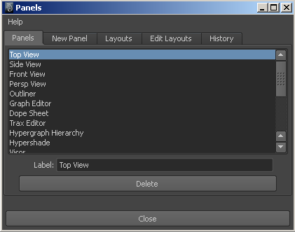

Panels
Displays existing Maya UI panels that you can rename or delete.
  • Select a panel and edit the Label field to rename it. You cannot rename the Top View, Side View, Front View, or Persp View panels.
  • Select a panel and click Delete to remove it from the list.

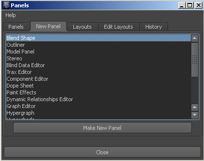

New Panel
Contains controls for creating a new panel type.

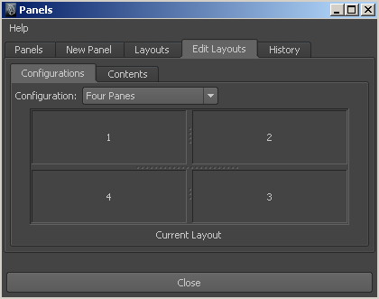

    Configurations
    Use this tab to change the configuration and proportions of the layout.
    From the drop-down list, select the panel layout you want.
    Resize the panes by dragging the borders in the thumbnail view of the layout. The main window changes to reflect your changes.

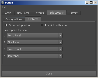

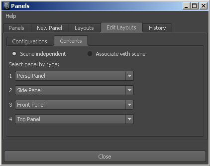

    Use this tab to change which panel contents appear in the layout.
    Scene Independent
    Scene independent layouts are available for all scenes. Their contents are defined by panel types.
    If you have multiple panels of the same type in a scene, it is not certain which panels show up when you select your layout. This is not a problem in most cases; however, if you are working a lot in a particular scene, you may want to develop layouts to save specifically with that scene.
    Associated with Scene
    These layouts are only usable with the current scene. You can specify a particular panel if you have more than one of the same type.
