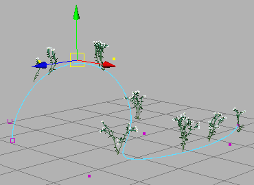

To change the shape of a stroke
- Select the stroke.
- Show the underlying stroke path curve (select ).
- Select the stroke path curve.
- Right-click to open the marking menu, then select Control Vertex to enter CV selection mode.
- Select the CVs and use the
Move Tool to translate them.

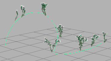

- Hide the underlying stroke path curve (select ).
- Return to object selection mode.
