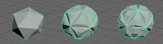

A polyPlatonic node is created whenever a platonic primitive is created.
Primitive
Determines the base face shape (by number of sides) of each side of the primitive. Options include Tetrahedron, Cube, Octahedron, Dodecahedron, and Icosahedron.
Subdivision mode
Determines the shape to further subdivide each face of the primitive into. Options include Quads, Triangles, Pie, and Caps.
Subdivisions
Determines how many times the base faces are subdivided using the Subdivision mode.
Inflate Sphere
Determines how much to push subdivisions outward away from the center of the primitive.
