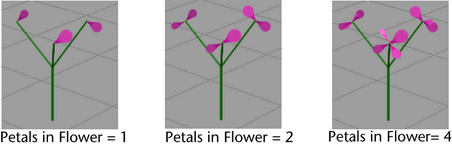

- Petals In Flower
When flower petals are created, they are created in radial clusters (flowers) at one position around a branch or twig. This setting defines how many petals are in each cluster. You can bunch multiple flowers together to make more interesting flowers.

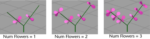

- Num Flowers
Defines the number of flowers created between Flower Start and the end of the tube’s lifespan.

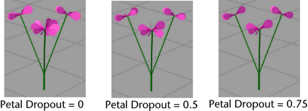

- Petal Dropout
Defines the proportion of petals that are randomly “pruned” to give a more natural look. If Petal Dropout is 0, then Paint Effects produces exactly the same number of petals each time it creates them. If Petal Dropout is 1, all petals are pruned.

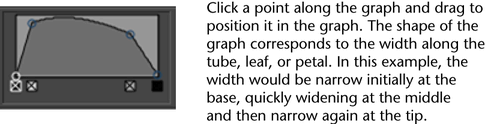

- Petal Width Scale
This allows you to use a graph to control the width from base to tip of petals, rather than using a simple linear interpolation between two values. When combined with the Brush Type you can define shapes like spheres, as well as control the profile of a petal. Width Scale is applied as a scale to the current width and defaults to 1.0 so that previous presets work with it.

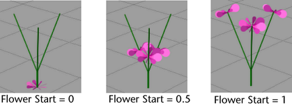

- Flower Start
Defines the point along a tube where flowers first appear. For example, if Flower Start is set to 0.5, then flowers appear halfway along the length of the tube (measured in segments). Increasing this value pushes the flowers toward the tips of the tubes.

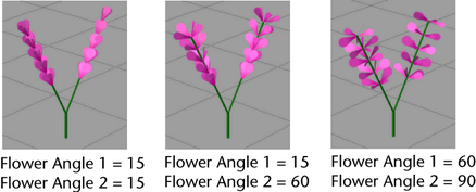

- Flower Angle 1, Flower Angle 2
These settings define the range of angles that the flowers will make with their source branch. The first flower created (closest to the root) uses Flower Angle 1, and the last flower created (closest to the tip) uses Flower Angle 2. The angles of the flowers change linearly in between them.

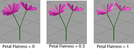

- Petal Flatness
Defines how flat the flower petals are. If Petal Flatness 0, the petals are tubes. If it is 1, the petals are completely flat.

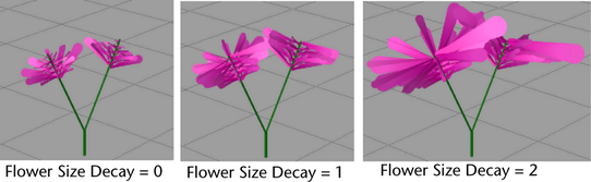

- Flower Size Decay
Defines the size factor applied to each flower petal. If the value is 1, all petals are the same size. As this value decreases, petals towards the tips of branches are smaller.
