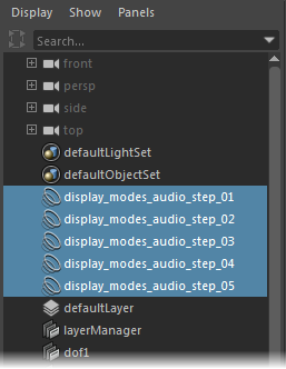

You can also remove sounds from Outliner, or use commands in the Edit menu on the main menu bar.
