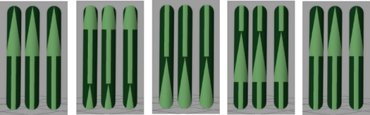

If tubes have gaps, twist, and/or textures applied to them, you can animate the pattern they create “flowing” or cycling along the length of the tubes as if the tubes were joined at the ends.
By animating the flow of gaps, you can create effects such as rainfall. By animating the flow of twist, you can get a spiraling effect. The following images show a texture flowing one complete cycle from root to tip.

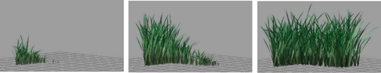

Animate uniform tube growth
You can animate the tubes along the stroke path growing at the same time, as if they were all “planted” simultaneously. Any gaps, twist, and/or texture applied to the tubes will flow along the length of the tubes as the tubes grow.

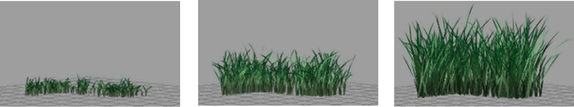

Animate the growth simulation
You can animate the growth simulation. Tubes “planted” at the beginning of the stroke start growing at the beginning of the stroke path and continue to grow as new tubes start growing in steps along the path. Any gaps, twist, or texture applied to the tubes will flow along the length of the tubes as the tubes grow.

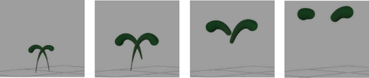

Animate tube death
You can animate special effects, like tubes “bursting” from the stroke path, by setting birth and death times that define when tubes start growing in the animation, and when they begin to disappear.
When the animation reaches the death time, segment at the tube roots disappear (or die) while segments continue to be added at the tube tips. When the tube reaches its life span, the segments continue to disappear from the root to the tip until the tube completely disappears.
