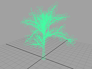

Create a tree
You will begin by creating a tree using Maya’s Paint Effects tool and then transforming the leaves into nCloth objects.
To create a tree using Paint Effects
- Select the Paint Effects tab on the Maya shelf.
- Select the
Simple Tree brush and paint a single tree in your scene.
You can use the Scale Tool to make the tree bigger, however the instructions in this example are designed for the default size.

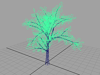

- Select Modify > Convert > Paint Effects to Polygons. (See Paint Effects to Polygons for a description of the options.)
- Change to the Select Tool and select the leaves.
- In the
FX
menu set (F5), select
nCloth > Create nCloth.
Maya creates a solver called nucleus1 and adds the leaves to it.

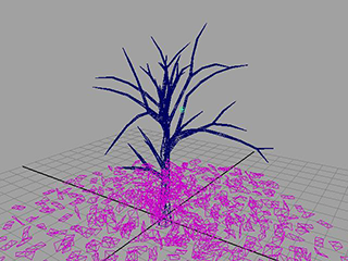

- Set the End Time of the playback range to 50.
- Play back the simulation.
The leaves fall straight down from the tree to the ground.
The leaves now bend as they fall and hit the ground. They also do not fall straight down, instead they blow about a bit on the ground. You can further adjust these settings to refine the effect.

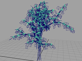

To constrain the leaves to the tree
- Shift-select the leaves and the tree.
- In the FX menu set (F5), select nConstraint > Component to Component.
- In the
Attribute Editor, select the
DynamicConstraintShape1 tab and in the
Dynamic Constraint Attributes section adjust the attributes as follows:
- Connection Method: Within Max Distance
- Max Distance: 0.1
- Glue Strength: 0.04
Note:
If you scaled the tree you must alter these values to achieve the desired effect. The larger the tree is scaled, the higher these values must be.
The leaves stay attached to the tree.

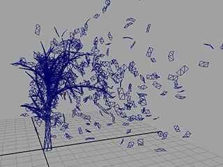

Blowing the leaves off the tree
To blow the leaves off the tree using wind
- Select the leaves.
- In the Attribute Editor select the nucleus1.
- In the Gravity and Wind section set Wind Speed to 40.
The leaves blow off the tree.
