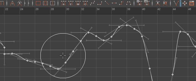

Using a Buffer Curve to view the effects of the Smooth Curve Sculpting tool.
To view the original and result animation when editing curves
- Before editing the curve, select it in the Graph Editor.
- Do one of the following:
- Select Curves > Buffer Curve > Snapshot from the menu bar.
- Click the
Buffer Curve Snapshot button
in the toolbar.
Note: Turn on View > Simple Toolbar if you do not see this icon.
A gray curve representing the current curve appears in the graph view.
- Edit the colored curve.
- You can switch between the edited curve and the original curve (buffer snapshot) by clicking the following:
- Select Curves > Swap Buffer Curve from the menu bar.
- Click the
Swap Buffer Curve button
in the toolbar.
Tip:
You can customize the default Buffer Curve and Buffer Curve key colors in the Preferences menu Color Settings.
