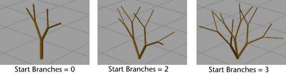

- Start Branches
Defines the number of branches at the root of the tube.

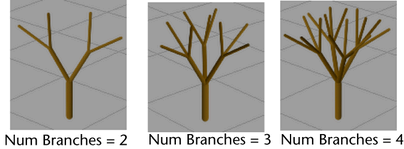

- Num Branches
Defines the number of branches created at each split. See also Branch Dropout below.

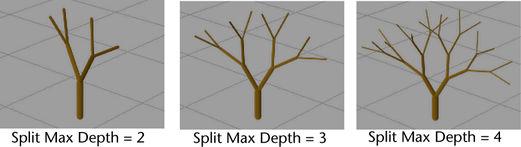

- Split Max Depth
Defines the maximum number of times a tube can branch.

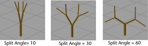

- Split Angle
Defines the angle that the branch splits from its original path.

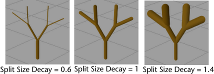

- Split Size Decay
Defines the tube size factor applied at each branching. If the value is 1, then the branches are the same size as the branch they branched from. If the value is less than 1, the branches are smaller than the branch they branched from (like on a real tree). If the value is greater than 1, the branches are larger than the branch they branched from.

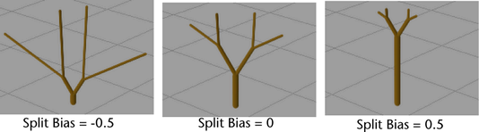

- Split Bias
Defines how to distribute branching along the tube. If the value is 0, branching is distributed roughly equally along the tube. Positive values push the branching towards the tips of the tube. Negative values push the branching towards the root.
