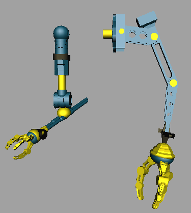

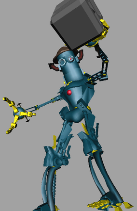

Suppose for a new animation, the robot must lift a heavy crate. However, these arms are too small for the animation.
If you open the referenced arm file, you can see the original arm is encapsulated by L_RobotArm_AST. You can model a second, more powerful arm here.
To create a second arm

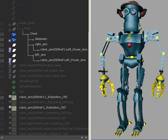

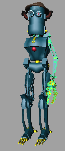

You now have two assets, each encapsulating one arm. However, if you use the Transfer Attribute Values option to switch the arm referenced by the main robot file, you get the following result.

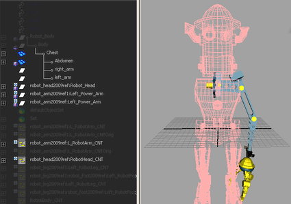

The arms appear on top of one another and are not translated properly. If you take a closer look at the hierarchy, you can see that the referenced arms are no longer located correctly in the character’s hierarchy (they are missing from underneath their respective groups). This is because the main robot scene no longer recognizes any of the nodes under the asset (for more information see Published nodes).
In order to swap the arms correctly, you must first publish the new arm as a child before you transfer its attributes.

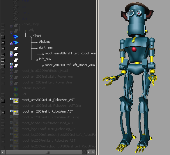

The new arm is organized under the asset L_robotArm_AST while the old arm is organized under the asset L_robot_arm_ASTOrig.
Now if you open the main robot file, the robot’s arms are replaced with your new, more powerful looking arms. Since you published these arms as children in their source file, Maya knows they are part of a hierarchy and uses their node information, not their name, to determine their place in the hierarchy.
As long as the published attributes of your new arms match the published attributes of the old ones, any associated actions (such as animation) are transferred from the old arms to the new arms.
