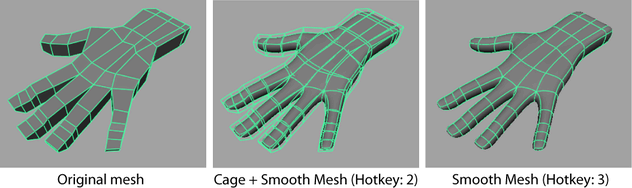

To cycle between different Smooth mesh preview modes
- With an object selected, press 1, 2, or 3
By default, meshes automatically display with Smooth Mesh Preview turned off. When Smooth Mesh Preview is turned on, you can display the original mesh and a smoothed preview simultaneously (Cage + Smooth Mesh display mode) or the smoothed preview by itself (Smooth Mesh display mode).
