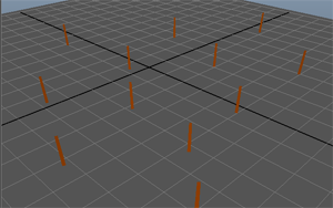

The following image represents a collection of guide locations:
The XGen algorithm first determines all the neighbors of each guide by detecting Vornonoi edges that separate guide-defined regions.

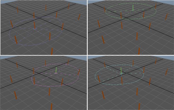

The following image represents a few examples of some guide range-of-influences found in our example.
The guide range-of-influence information stored with each guide is a collection of sweep angles and radii, appearing in Maya as a single-string attribute that you can also view in the XGen Collection file. You cannot edit a guide range-of-influence, but you can add guides until you get the ideal result.
The illustrations here show the how XGen intuits what area a guide controls; it looks near the guide and defines an imaginary fence that connects the guides that surround it.
