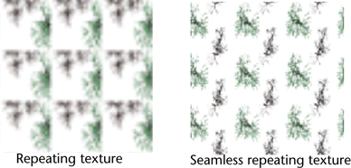

A repeating texture is created by tiling or repeating an image in a grid. A seamless repeating texture is one where you cannot see the border of each tile because the images match continuously at each tile edge (like aligning a wallpaper pattern at the edges of the paper).
You can create seamless repeating textures in Paint Effects using the wrap feature. The wrap feature enables you to paint across the edge of a canvas and have that stroke continue on the opposite edge, as if the canvas were wrapped into a cylinder and joined at the edges. You can wrap the canvas vertically, horizontally, or both.

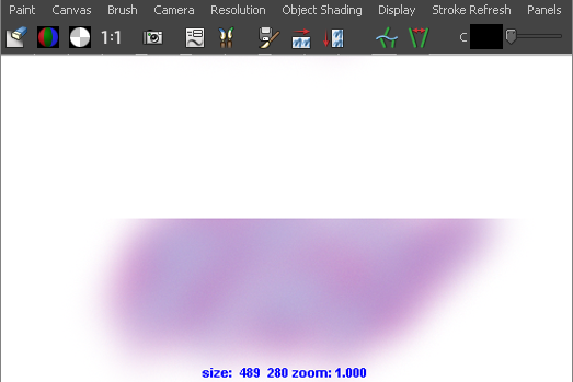

- Paint the canvas. For information, see Paint on the canvas. When you paint over the wrapped edges, the brush stroke continues on the opposite edge.

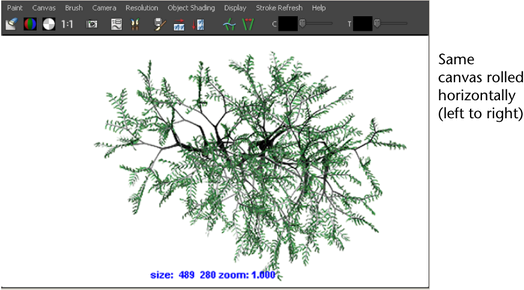

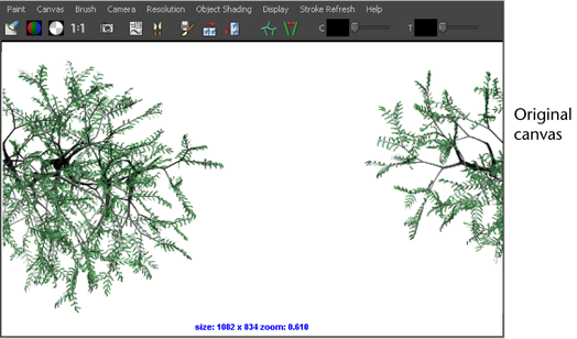

Roll the canvas
If you wrap the canvas, you may want to display the area where the edges join. You can do this using the roll feature. The roll feature rolls the canvas as if it were wrapped into a cylinder, so that the images move continuously from left to right, or from top to bottom.
This feature is also useful if you do not use the wrap function but want to correct any seams created at the edges of the canvas. In the following example, the canvas was rolled 50% vertically (top to bottom). The seam can now be corrected easily using an airbrush.
