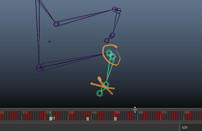

Blue Pencil
Click Blue Pencil to view a list of operations for Blue Pencil frames. See Work with Blue Pencil frames.
  • Insert Frame(s) adds a blank frame at the current time.
  • Duplicate Previous Frame creates an identical version of the previous frame at the current time. See the section Difference between Copy and Duplicate Previous Frame in the Work with Blue Pencil frames topic to learn when to use this option instead of Copy Frame(s).
  • Delete Frame(s) removes the frame at the current time.
  • Cut Frame(s) removes the frame at the current time and copies it to the clipboard.
  • Paste Frame(s) pastes the contents of the clipboard at the current time.
  • Copy Frame(s) copies the current frame to the clipboard. However, it does not remove the frame. See the section Difference between Copy Frame(s) and Duplicate Previous Frame in the Work with Blue Pencil frames topic to learn when to use this option instead of Duplicate Previous Frame.
  • Clear Frame(s) empties the drawings from current frame.
  • Display Frames lets you choose how frames appear on the Time Slider:
    • Always shows Blue Pencil frames on the Time Slider.
    • Selection/Context Active only shows Blue Pencil frames on the Time Slider when using Blue Pencil.
    • Off Hide Blue Pencil frames on the Time Slider.

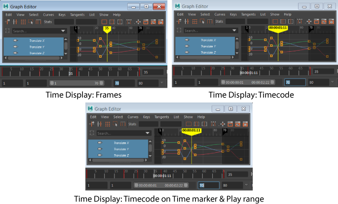

Time Display
Select what format Time information appears on the Time Marker:
  • Frames: Displays frames on all time rulers, current time markers, and input fields which display or accept time.
  • Timecode: Displays video standard timecode on all time rulers, current time markers, and input fields which display or accept time.
  • Timecode and frames on Time Marker: Displays video standard timecode on timemarkers while time rulers shown frames. This is the legacy display when Timecode is set in the in the Time Slider options in the Time Slider Preferences
