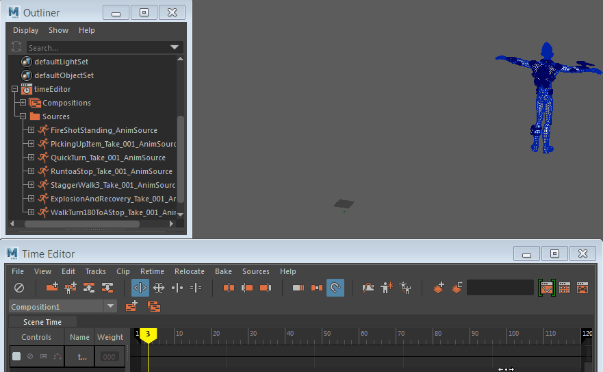

To create a clip from an Animation Source already in the scene
- In the Time Editor menu bar, expand the Sources menu.
- Select Create a Clip from Animation Source and choose the one of the sources listed.
The Animation Source is added as a clip to your scene,
You can also middle-mouse drag an Animation Source from the Outliner onto an Animation track in the Time Editor. The folllowing animation shows the Sven character being animated by a series of different animations in the Outliner Sources menu.
