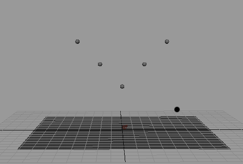

The particles turn black after you add the rgbPP attribute. Adding the rgbPP attribute turns off the default coloring of the particles and gives them a value of <<0,0,0>>.

- Rewind the animation.
Upon rewind, the particles are black. The particles have the default black rgbPP color because no creation expression exists for the object.

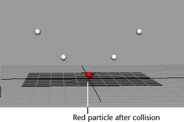

When the first particle of PeasShape hits the plane, Maya sets the event attribute for that particle to 1. This triggers execution of the first assignment, which sets the colliding particle’s rgbPP value to <<1,0,0>>. In the RGB color scheme, this vector value represents red. (When red equals 1, green equals 0, and blue equals 0, the resulting color is red.)

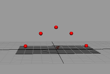

When the other particles hit the plane for the first time, they also turn red after they collide.
A particle stays red until it collides with the plane for the second time, when event equals 2. After a second collision, the particle turns green.

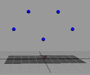

After a third collision, when event is equal to or greater than 3, a particle turns blue. Each particle stays blue for all subsequent collisions as the animation plays.
