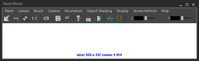

To open the Paint Effects panel:
- In the Panels menu:
- In the main menu bar: .
The default Paint Effects panel is the 2D canvas.
Paint Effects panel menu bar
These are the menu items in the Paint Effects panel menu bar. See also Paint Effects panel toolbar below.

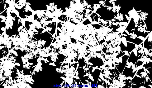

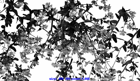

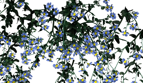

Each pixel in a color rendered image consists of three values or channels. Each of the three channels represents the amount of red, green, or blue in the image. Maya image files also contain an alpha channel (or mask channel) which represents the presence and opaqueness of objects, and a luminance channel which represents the intensity or brightness of the image.
You can display each of these channels individually as planes using the options on the Display menu. If you are in the scene painting view, the values that display are for the snapshot of the view, not just the rendered strokes.
- Red Channel
Display the red values channel for the image.
- Green Channel
Display the green value channel for the image.
- Blue Channel
Display the blue value channel for the image.
- All Channels
Display the red, green, and blue channel planes.
You can also use the Display RGB Channels icon on the toolbar.
- Luminance
Display the luminance values channel for the image.
- Alpha Channel
Display the alpha values channel for the image.
You can also use the Display Alpha Channel icon on the toolbar.
Note: Alpha channels for the scene painting view are completely white. To see the alpha of the scene painting view, render the scene () and in the Render View, select . - Toolbar

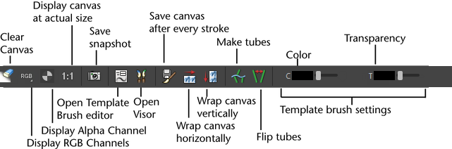

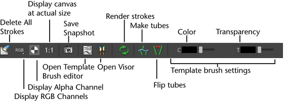

The buttons on the Paint Effects panel toolbar change depending on whether you’re painting on the 2D canvas or in the 3D scene.
Paint Canvas toolbar
Paint Scene toolbar
