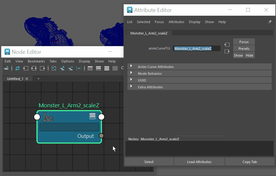

Node behavior
To change node behavior, select the node and expand the Node Behavior section of the Attribute Editor.
