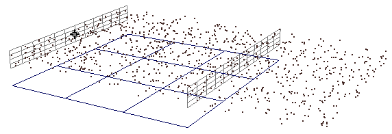

The surface flow effect emits particles that flow along the surface of any NURBS model. You can use this effect to create flowing fluids, gases, or instanced objects. The flow effect automatically adjusts to any changes in the shape of the surface.

An emitter and flow manipulators appear on the surface.

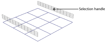

You can edit these attributes after you create the Surface Flow effect by selecting the surface flow selection handle and opening the Channel Box or the Attribute Editor, Extra Attributes section.
You cannot directly rotate or translate manipulators, because they automatically adjust to any changes in the shape of the surface. However, you can edit the Location attributes to move them along the surface.

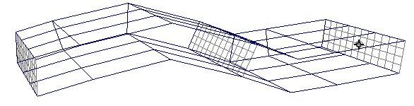

- Show True Manip Shape
By default, the manipulators are displayed as smooth bands that wrap around the base surface in exactly the shape that you specify. The actual shape that the effect uses depends on the Manipulator Resolution value that you set at the time you created the surface flow.
To see that shape, turn on the Show True Manip Shape attribute. This does not affect the way that the surface flow moves the particles. It simply lets you see how accurate the simulation is trying to be.

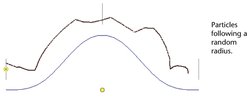

- Random Radius
Sets the amount of random changes in the particle emission radius, so that particles spread beyond the flow manipulator loft. Use this attribute to create a more natural effect.

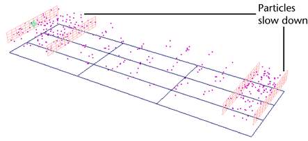

- U or V Location
Controls the position of each flow manipulator, measured in U or V. You can move manipulators anywhere along the surface in any order.
Typically, you adjust the manipulator locations to affect the particle speed. Particles slow down between manipulators that are close and speed up between manipulators that are distant.

Controls the beginning and end positions of each flow manipulator, measured in U or V. Adjust these values if you want the flow to cover only part of the surface. For example, you can break up a surface into two adjacent flows by ending one flow (Max setting) at the same point where the second flow begins (Min setting).

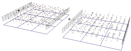

Connect flows on separate surfaces
You can connect flows from separate surfaces so they share the same particles. The workflow is different depending on whether you create flows at the same time or start with an existing flow.
To create connected flows
- Select the surfaces in the order you want the particles to flow.
- Choose >
. - In the options window, turn off Create Particles Per Flow.
- In the Control Resolution option, specify the number of flow manipulators per surface.
- Click Create.
The effect creates one flow per surface, with the particles flowing in the order of selection.

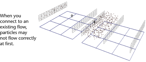

To connect an existing flow
- Select the particle from the existing flow, along with the surfaces or flows you want to connect. (The selection order doesn’t matter.)
- Choose .
There will be one flow per surface, but the particles may not flow correctly. Correct the flow of particles using the following steps.
- For all flows after the starting flow, change the Emitter Rate to 0 (zero).
- In all the flows, adjust the Min and Max Age Ratio settings so the particle life span extends evenly among all flows.
