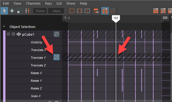

In the Dope Sheet Editor, you can mute channels using an icon in the Dope Sheet Outliner.
To mute channels in the Dope Sheet
  1. In the Dope Sheet Outliner area, select the channel you want to mute.
  2. Select Channels > Mute Channel or click the Mute icon next to the channel name.
    The muted channel appears greyed out with diagonal stripes in the View area
    You can still view, manipulate, and add keys to a muted channel in the Dope Sheet. This is useful when you want to isolate and review specific parts of your animation. When you edit a muted channel in the Dope Sheet, the corresponding animation channel updates in the Dope Sheet view areas.

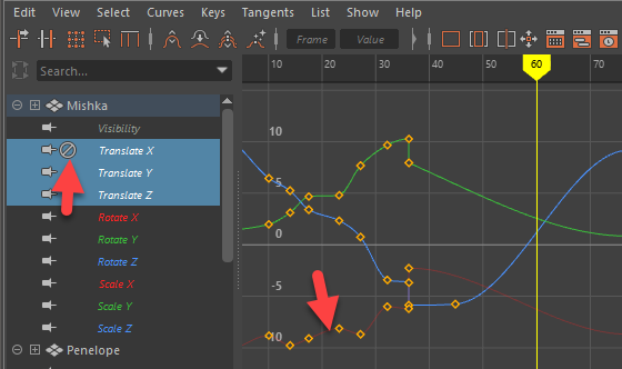

In the Graph Editor you can mute channels using the Mute Channel option in the Graph Editor Curves menu.
To mute curves in the Graph Editor
  1. In the Graph Editor Outliner, select the channel you want to mute.
  2. Select Curves > Mute Channel from the Graph Editor Curves menu.
    A muted curve appears in the View area. .
    The muted curve appears as a dimmed curve in the Graph Editor
    You can view, manipulate, and add keys to the muted curve in the Graph Editor. This is useful when you want to isolate and review specific parts of your animation. When you edit a muted channel or curve in the Graph Editor, the corresponding animation curve updates in the Graph Editor.
