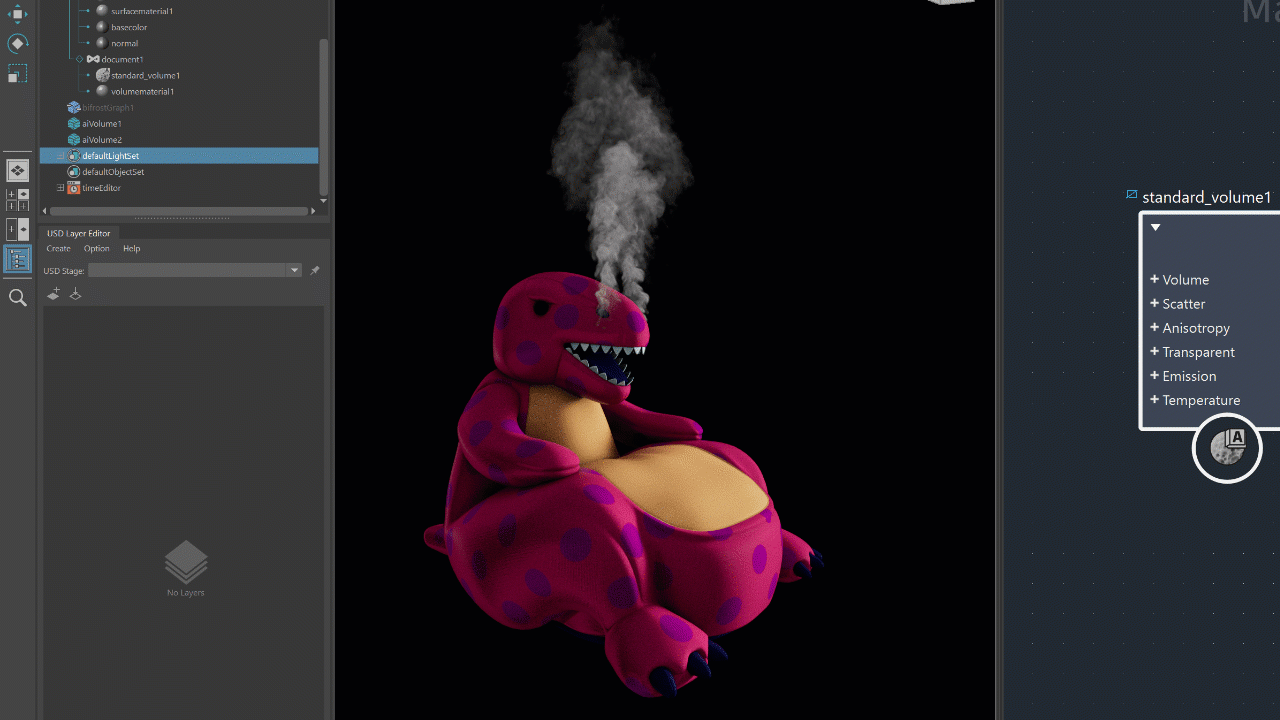

  • Support for volume shaders
    In addition to surface and displacement shaders, this update also supports volume shaders.
