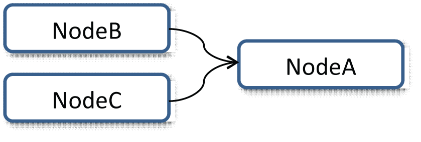

Parallel scene evaluation takes advantage of all available computational resources to evaluate scenes more quickly. This is done by building an evaluation graph from the scene description using the dirty propagation mechanism.
For the evaluation graph to generate correct results, dependencies must be accurately expressed in the DG. If node dependencies are incorrect for your scene, parallel evaluation will produce wrong results, or Maya may crash.
For example, in a scenario where NodeA depends on NodeB and NodeC, the evaluation manager must compute the state of NodeB and NodeC prior to calculating the state of A.
