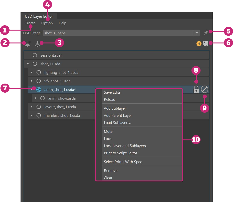

USD Layer Editor Interface
| # | Option | Description |
| 1 | Create a stage | Select from this menu to create a new USD stage or create a stage from an existing USD file. |
| 2 | Add a new layer | Click |
| 3 | Load an existing layer | Click |
| 4 | Options menu | Select Options > Auto-Hide Session Layer to automatically hide the session layer. |
| 5 | Pin a stage | Click |
| 6 | Save a stage | Click |
| 7 | Set target layer | Hover next to a layer name and click the grey target icon |
| 8 | Lock a Layer | Click |
| 9 | Mute a Layer | Click |
| 10 | Context menu | Access the context menu by right-clicking a layer. |
