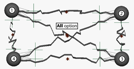

- All
Creates lightning between all the selected objects.

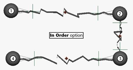

- In Order
Creates lightning from the first selected object to the other selected objects in the order of their selection.

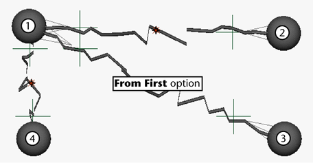

- From First
Creates lightning from the first object you select to all the other selected objects.

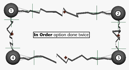

Tip:Notice in the illustration for the In Order option above, the lightning does not extend from object 4 back to object 1. If you want to do this, you need to add another lightning effect between objects 4 and 1.

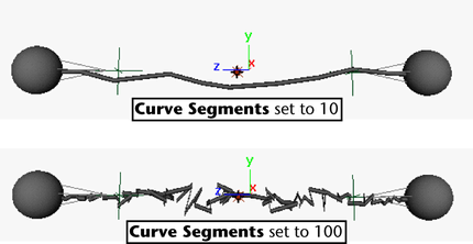

- Curve Segments
Lightning is made up of soft body curves with extruded surfaces. The Curve Segments value sets the number of segments in the lightning.
