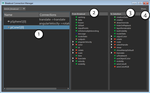

The Breakout Connection Manager allows you to manage all breakout connections between a MASH network and object in the scene. You can access it from the Breakout node's Attribute Editor tab.
| 1 - Connection Summary | Displays any existing connections to this
Breakout node. You can also select objects here to create new connections in the right panel.
Right-click to display a menu that allows you to break connections, remove objects, change IDs, or create empty groups. |
| 2 - From Breakout | Displays the attributes of the MASH network. Select an attribute here, then select an attribute in the To Selection section to create a new connection. |
| 3 - To Selection | Displays the attributes of the selected object. Select an attribute here after selecting an object in the From Breakout section to create a new connection. |
| 4 - Show | Filters the attributes shown in the To Selection section. |
