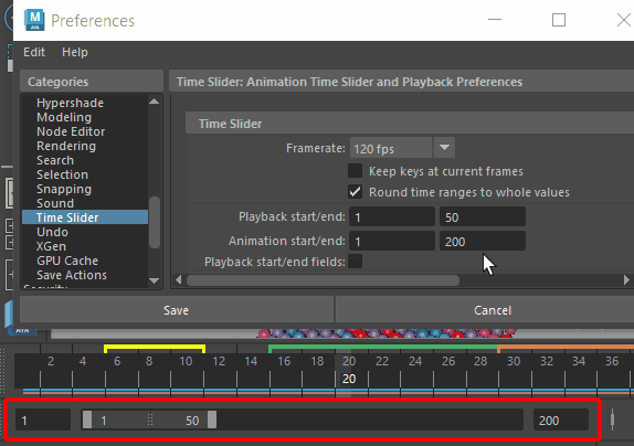

Time Slider
- Framerate
- Set a frame rate for the current scene.
Frame selections include: 2 fps, 3 fps, 4 fps, 5 fps, 6 fps, 8 fps, 10 fps, 12 fps, 15 fps, 16 fps, 20 fps, 23.976 fps, 24 fps (Film), 25 fps (PAL), 29.97 fps, 29.97 df (drop frame), 30 fps, 40 fps, 47.952 fps, 48 fps (Show), 50 fps (PAL Field), 59.94 fps, 60 fps (NTSC Field), 75 fps, 80 fps, 100 fps, 119.88 fps, 120 fps, 125 fps, 150 fps, 200 fps, 240 fps, 250 fps, 300 fps, 375 fps, 400 fps, 500 fps, 600 fps, 750 fps, 1200 fps, 1500 fps, 2000 fps, 3000 fps, 6000 fps, 44 100 fps, and 48 000 fps.
- Keep keys at current frames
By default when you change the current time unit, the times for any existing keys are modified so that playback timing is preserved. For example, a key set at frame 12film changes to frame 15ntsc when the current time unit is changed to NTSC, since they both represent a key at 0.5 seconds. When this option is on, it leaves the key at 12ntsc that was originally at 12film. The default setting for this option is off. The option turns on once the current Time unit is changed above.
- Round time ranges to whole values
Activate this setting to retain whole frame values whenever frame rates change. Sometimes changing the frame rate in Maya converts current frame, frame range, and animation range numbers to decimal value numbers.
This option is active by default. Disable it if you want frame numbers to be precise after changing the frame rate, for example, 24.80.
- Playback start/end
Specifies playback range start and end times. The playback start and end times specify the Time Slider playback range. The playback range is always within the animation range. You can also specify the time units. See Edit animation preferences.
- Animation start/end
Specifies animation range start and end times. The animation start and end times specify the Range Slider range. The playback range always stays within the animation range, so changing the animation start and end times can also change the playback start and end times. Default animation start time is 1.00. Default animation end time is 48.00. You can also specify the time units. See Edit animation preferences.
- Show Playback fields
Playback Start End fields
- Turn this option on to display the Playback Start/End fields on the Time Slider.

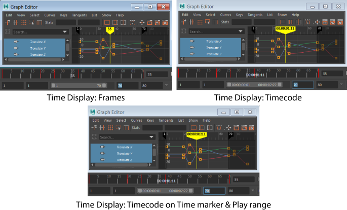

- Time Display
Select what format Time information appears on the Time Marker:
- Frames: Displays frames on all time rulers, current time markers, and input fields which display or accept time.
- Timecode: Displays video standard timecode on all time rulers, current time markers, and input fields which display or accept time.
- Timecode and frames on Time Marker: Displays video standard timecode on timemarkers while time rulers shown frames. This is the legacy display when Timecode is set in the in the Time Slider options in the Time Slider Preferences
Note: An asterisk "*" appears next to any number in the Time Slider that has been rounded to the second decimal place to indicate the value has been approximated. This happens sometimes when you switch between Time Code and Frames or if the Snap to Whole Frames option is disabled in the Time Slider preferences.
