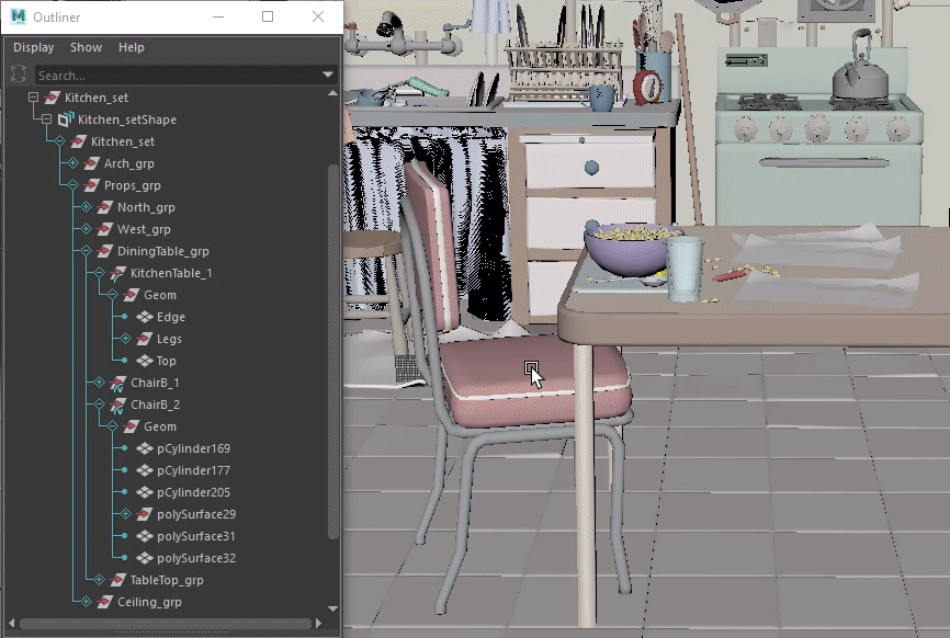

Select USD data in the Viewport
When working with a USD set in Maya, clicking in the Viewport selects an exact prim. This often results in the partial selection of a model. If you want to manipulate an entire model or set, you need to manually select it in the Outliner. You can override this behavior with the optionVar UsdSelectionKind

Using the Command Line for Selection by Kind
- Selection by Kind has the following modes:
optionVar -sv "UsdSelectionKind" "model" ;
Selects the nearest ancestor that is a model or its subcategory.optionVar -sv "UsdSelectionKind" "group" ;
Selects the nearest ancestor that is a group or its subcategory.optionVar -sv "UsdSelectionKind" "user-defined" ;
Selects the nearest ancestor that is a user-defined kind or its subcategory.optionVar -sv "UsdSelectionKind" "" ;
Selects the exact prim that is picked in the viewport. This returns Viewport selection to its default behavior.
In the following example, we override the default Viewport selection behavior to select entire models in the USD set:
