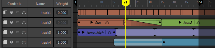

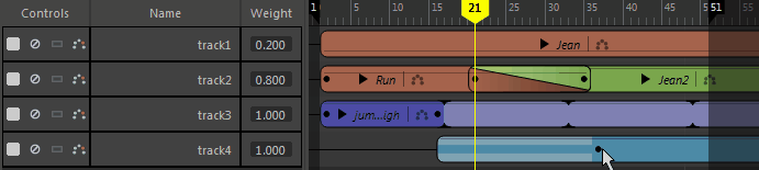

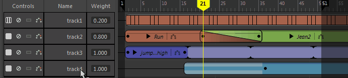

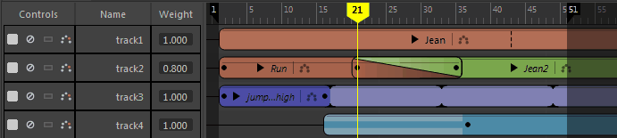

- Change track weight
- Changing track weights lets you determine how much of its animation plays in your scene. Enter a value in the Track Weight field.
- See Key Time Editor clip weights.
