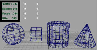

Column Shows... Left
Total counts for all visible polygons.

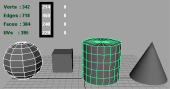

Middle
Counts for selected polygons.

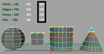

Right
Counts for selected components on objects that are partly visible in the view.

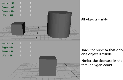

Changing your view can affect the counts
The Poly Count display only counts visible objects (whether they are selected or not). If you track the view so some objects are no longer visible, they will not be included in the polygon count.
This can be useful for games developers to get an idea of how many polygons a given view will require.
