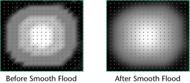

Flooding soft body goal weights
Flooding soft body goal weights is like taking a huge brush and applying its settings to all the particles on the soft body. When you flood a soft body, Maya changes the goal weight of each particle on the soft body according to the value and operation set for the Paint Soft Body Weights Tool.
To flood a soft body, follow the steps under Color Feedback setting; Select Cluster Mode hotkey;To paint goal weights on a soft body, but instead of painting in step 5, click the Flood button or use the hotkey Alt + f (Windows and Linux) or Option+f (Mac OS X).
Tip:
To smooth the transition between goal weights on a soft body, select the Smooth paint operation and flood the soft body.
