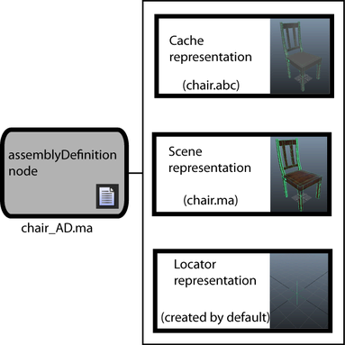

The following image illustrates a typical assembly definition.
