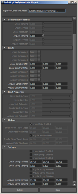

  1. Select one or two rigid bodies. If you select only one rigid body, the constraint is anchored to its position in Maya worldspace.
  2. Select Bullet > Create Rigid Body Constraint >
    See Bullet Constraint Properties for descriptions of each property.
