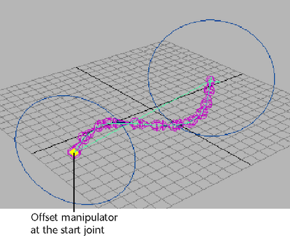

To slide the joint chain along the curve
  1. Select the spline IK handle.
  2. In the Attribute Editor, select the ikHandle node tab.
  3. In the IK Solver Attributes section, turn on Root On Curve.
    This constrains the start joint of the spline IK handle to a position on the curve. It also provides an offset manipulator to slide the start joint along the curve.
  4. Select Modify > Transformation Tools > Show Manipulator Tool.
    The offset manipulator appears at the start joint.

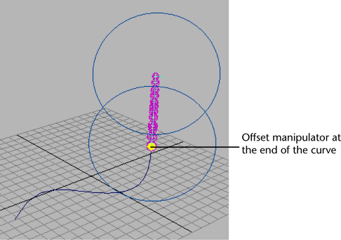

  5. Do one of the following:
    • Drag the manipulator to slide the joint chain along the curve.
      If you drag the start joint to the end of the curve, the child joints move off the end of the curve in a straight line.
    • Enter values for Offset in the Attribute Editor to move the root of the spline IK chain along the curve.
      Note:
      • You cannot drag the manipulator past the ends of the curve.
      • If you turn Root On Curve off, the Offset attribute is ignored.
