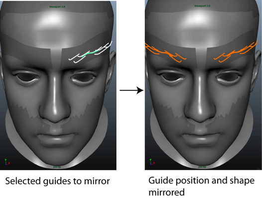

Mirror guide position and shape
You can use the Mirror Guide tool to mirror guide position and shape across the X-axis of your polygon mesh. Use this to generate two areas of primitives that are symmetrical, such as eyebrows and hair grooms.
- Select the guides you want to mirror across the geometry's X-axis.
- From the XGen toolbar, click the
icon. XGen adds new guides at positions and with shapes that mirror the selected guides.
